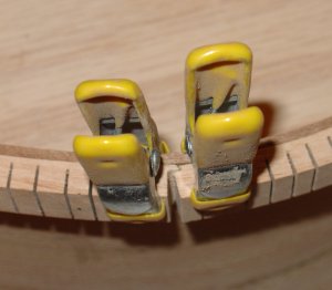

This weekend I made up some kerfed linings Cumpiano style. when test fitting my first, it split at the waist. In fact I split three at the waist.
Is it ok to wet this area of the lining and then glue it? I not sure if this will wreak havoc on the area as it dries. Also, is it ok to use the cracked lining?

Chris, it's okay.
Looking at your spacing, I'd say this is shopmade not factory lining? Just guessing.
You can make the linings much more flexible by making smaller width spaces on the lining.
Or, you can make it more flexible, by double cutting the linings.
By double cutting, I mean cutting into the blocks from the back side, hence giving room for the wood to conform to the curve of the guitar side.
I don't know of anyone doing that, except the recent Ryan linings which were posted by Cornerstone recently.
Like I said, it is okay to just glue and go. But learning something here is probably more important. How to, easily, make it work better in the future, eh?
PostPosted: Mon Aug 06, 2007 1:40 am
Looks like the depth of your cut is inconsistent and appears to be a bit shallow.
The cracked lining will work OK, unless you're using reverse kerf to get a stiff rim.

You can glue them either way, but you will need to take the cuts a lot deeper at least in 3 bent areas, or try double cuts as Bruce suggested. I made a test piece after reading that recent thread, and it does create a very very flexible line indeed.

Once you get the cuts a bit deeper, another trick is to put a piece of tape (good masking tape or similar) along the side with the cuts before you bend it at the waist. This helps to control the bend and reduces breakage.
This is a tip I got from Jeremy Clark, and it does work well if you are using slotted linings (aka kerfing).

Thanks for the tips everyone. I'll get the hang of all this in a year or two.
I made the lining according to the Cumpiano book with just a 1/64" thickness of what he called the 'web' and 1/4" or less spacing between kerfs.
Hesh: The do have a chamfer on them. They just weren't visible in the photo above since I was taking the pic from the top. I do like your joining of the two pieces. That is good to know. Thanks.

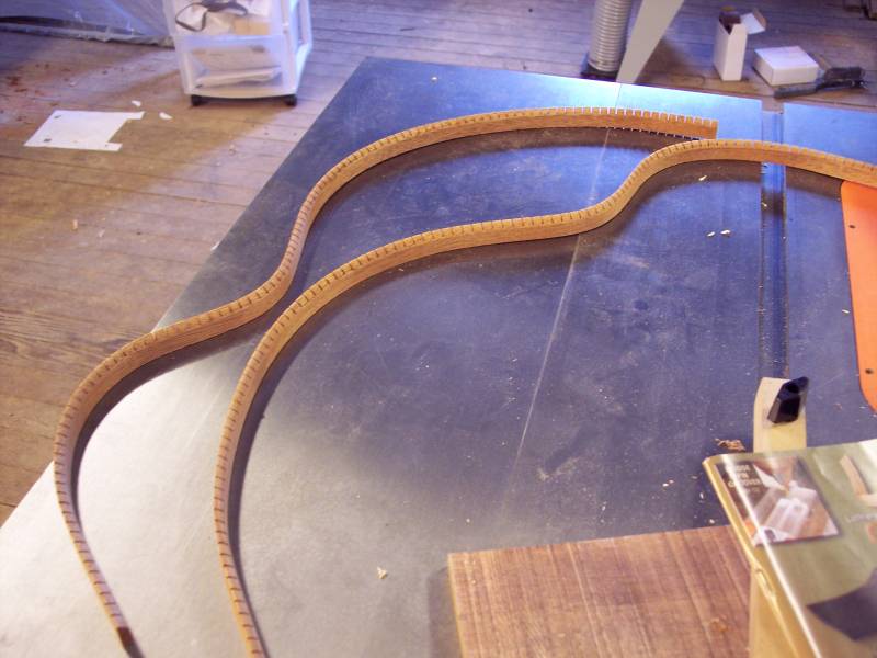

PostPosted: Mon Aug 06, 2007 10:40 am
Posts: 252
I throw mine on my side bender before installing them.  That pre-bends them and keeps them from breaking at the waists.
This what they look like out of the bender just before glue-up.
